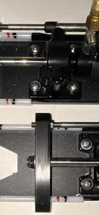

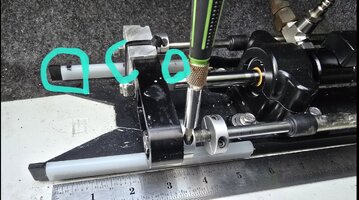

A easy way to check overall steering is to make a few marks on the ram slides.
Step one with the boat off, turn the hydraulic pump bypass knob fully open.
Then push the ram/ cylinder fully extended and mark this position on the white slides.
Now fully retract the ram/cylinder and mark this position on the white slides.
Next I measured this overall length and found center.
Now put ram/cylinder in the center position. (This is not critical the system will self cent during next restart.) After centered close the / tighten the bypass knob.
Now with the boat running turn fully left then fully right While checking to see if you are getting full movement from the system.
My boat spent 2 months at the dealer with just 4hrs on it. They ended up putting 25hrs on it trying to fix steering issues, I'm ok friends with the service manager so I was kept in the loop. I also helped during some of the testing.
My ram/cylinder magnet position sensor was loose inside the cylinder causing faults.

Here is a pic of what is left of my marks.
