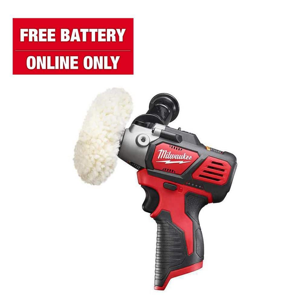

I actually do have a rotary polisher/sander that should fit the bill. I guess I just need to order some hook and loop sanding pads for it. Probably 400, 600, 800, 1000 grit at least. Maybe I can find a kit with multiple grits going up to 2000 grit. I have the polisher/sander linked below:
I've been hesitant to do any "machine sanding", but it would definitely make this job go much faster. It sounds like you've done a similar repair before. Any tips on what RPMs I should be using when machine sanding and recommended grits?

My previous jobs, I used a right angle Milwaukee drill and a 3" pad kit, with some wet/dry by hand, as I didn't have the 3" paper. The speed isn't fast enough to do quick damage like your 7", but the size is nice enough to make for easy handling.
I did use the paper under a foam pad to help it go faster, and as a kind of test to see if I should get the M12 polisher, and I was convinced. I've used that polisher for headlight restoration and 2 small gelcoat areas I tested, once I got some 3" paper, and IMO, it's perfect for guys like us, with stuff like this. It's manageable, and fast enough for these things without being too fast that a novice would do damage. It's also perfect, size-wise, for laying on your back.

Thanks @drewkaree for details on the M12 Polisher/Sander. I've got several other M12 tools and have looked at this one a couple of times. Last time I did some gelcoat repair I used a variable 1/4" hex M12 drill I already owned M12 Variable Hex drill with a Groits polisher adapter bit
Groits adapter bit
And an adapter plate with hook/loop
2" Adapter plate and 3" Adapter Plate
Here's a multipack of 3" sandpaper on Amazon. I can't vouch for it, but I guess they do make it
3" High Grit Sandpaper hook/loop
Variable trigger controls the speed, though I wasn't the best at it I didn't cause any damage by taking my time. Found several sources online for the hook/loop sanding pads as well as polishing ones. For the really fine stuff I did wet with a block by hand as I didn't find any of the really fine stuff for 2" or 3" adapter plates the last time I looked, but the link I've found here it looks like I didn't look hard enough.
TBH, the whole time I was thinking about this M12 polisher mentioned here more than once. But again just took my time and knocked it out.

Milwaukee sells additional kits for a ridiculous $67-ish, for the exact same setup that they ship with the unit. Spending $20 for adaptors allow you to buy the generic $20 kits and replacement velcro backing plates, and/or another $20 for collets. Depends on what you need, and how it's offered, but for an additional $40 for 4 pieces, you're completely covered for whatever is available. I'll try to remember to post links when I get home, as it's an odd size, both for the threading into the Milwaukee tool, and the other pads.
They have adaptors that let you bump up to 5",but it really isn't designed to properly utilize that size, and I think you'd be better served with a different machine if you want 5" pads

So this is all for the Milwaukee m12 polisher, although the pad kit I originally bought will work with any drill with a 3-jaw chuck - I did a similar thing @Tjw961 did, and used a right-angle drill that I already had. I could have saved myself some money by just jumping straight to the polisher, but the pad set was only $10 at the time.
The original pad kit I got was this, and I bought wet/dry paper separately, using these pads to compound & polish after sanding (hit the link, and they'll have other suggestions, as these are no longer offered, but it's just a generic Chinese kit like this one, as an example) Those had a solid smooth shaft, which is why you needed the 3-jaw chuck, but they make a collet for the polisher, if you prefer the smooth shaft vs threaded products.
IF you end up with the polisher, you can use the pads that come with it, but you'll need more as you consume the 3 pads they include with the kit, and like I mentioned, they have them priced at a ridiculous $70 for the Milwaukee-branded kit. Search Amazon for "Milwaukee m12 Polisher pad", and you can find a ton of pad kits. I have no way of knowing what does or does not work with the Milwaukee tool without reading the specs, which you can do as well, so I'm just giving you what I ended up with that works.
Milwaukee has an odd size thread for the polisher, likely to try to force you to use their expensive replacements, but you can get other velcro pads, and adapters to allow much less expensive alternatives. I went with these velcro pads, to allow easy pad changes, and that mated up with this adapter, to screw directly into the Milwaukee polisher
Lastly, @WiskyDan had a hand sander version of this kit, and in looking for what it included, I stumbled across a kit that would work in the polisher, so I grabbed that, and the adapter as well. This kit has wet/dry paper, a velcro pad to allow easy changes, and several options for mounting to the polisher. It comes with a smooth shaft that can be used with the collet linked above, or you can remove the threaded nub in the pad, and grab this adapter to thread directly to the pad
After all is said and done, you can just pick one method for attaching to the polisher and skip all the extra adapters, but I got the adapters, not knowing just what would work, and I figured I would just send back what I wasn't going to use. I decided to keep all the adapters, in the event Amazon doesn't have a kit at the time I would need it, I'm covered. The outlay was an additional $30-40 for the adapters, and I figured they would pay for themselves by not having to shell out $70 every time just because it had a fancy logo on it.
This may be a lot to follow, so I can help if anyone has questions regarding how to determine what to look for, but as long as you can suss out the thread pitch and size needed to interface with the Milwaukee polisher, you can cobble together a cheap and effective kit with the info I've linked above.
