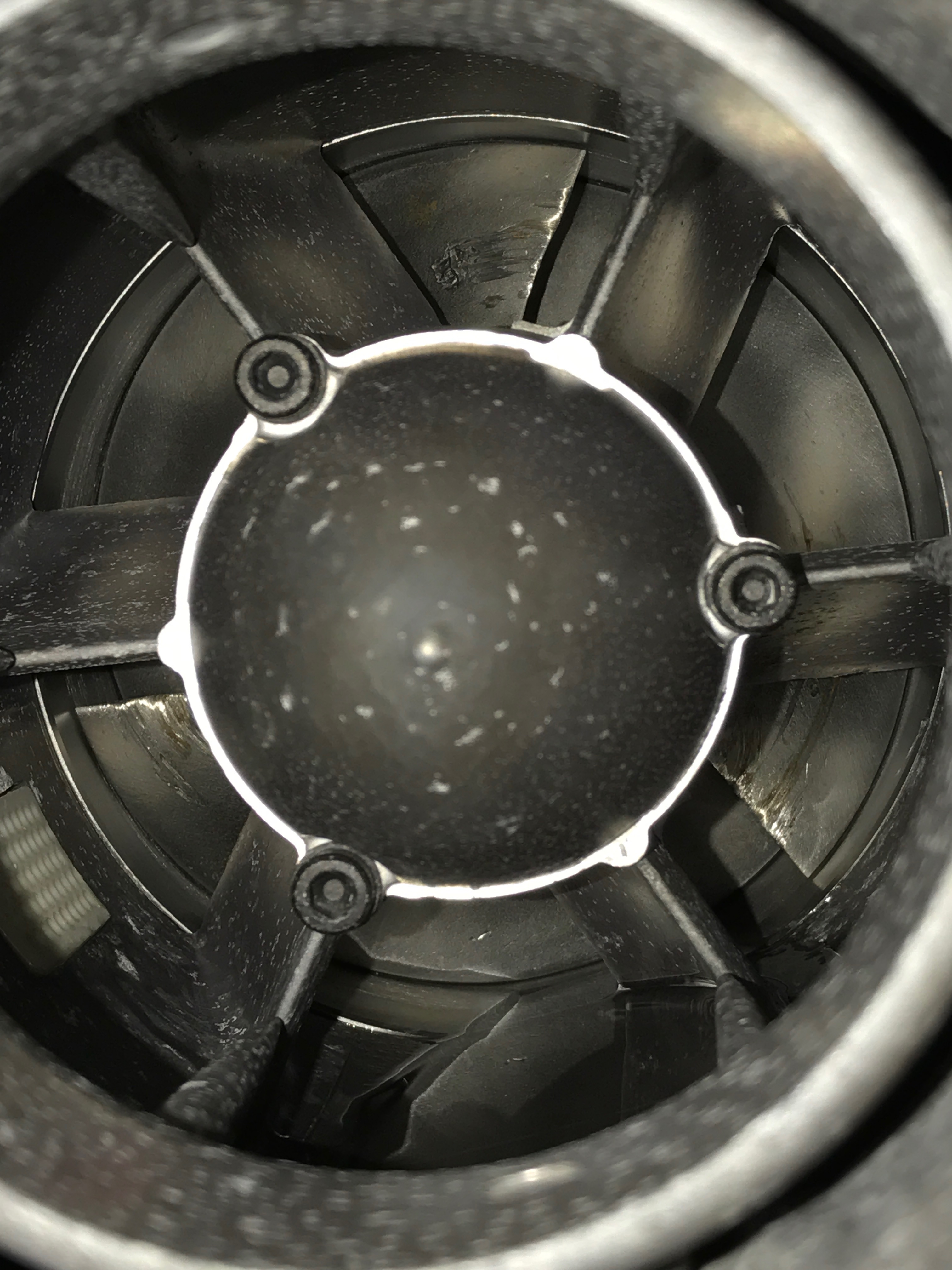

So I took a picture tonight -- it doesn't look that bad to me. Could this really be the cause of my performance issues?
Oh heck yeah, that could explain your cavitation issues. Looks like you have found some gravel/rocks. These pumps are like huge vacuum cleaners, can pick up large rocks from 3 ft away.
I would definitely pull that pump and the impeller. There is clearly damage on the trailing edges which per se is not a huge problem, but who knows what the leading edges look like. And the OD - that really drives cavitation if you are off specs (the gap between the wear ring and impeller blades).
Do you have the shop manual? if not, please pm me your email I can send you a copy. COmes in handy.
That thing has been used to film an episode of will it blend!
well there you go...I didn't think it looked that bad!
