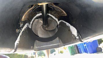

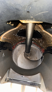

The cavitation seems excessive... Maybe seal your intake tunnel and have you done a rebuild kit on plug recently? I did both when I bought my 2021 used this year. I still have the stock cone and stock impeller.

I have tried sealing the intake tunnel, but I didn't remove the grate. It's possible I could do a slightly better job. The cleanout plug looks like it's in good shape - my boat is a 2021 also but I didn't see any wear around the seal when I looked at it recently.

The twin scroll won't hurt surfing, only improve it. It keeps the pump loaded, similar to how a intake grate works on wave runners. But if you have tunnel, sealant, pump plate and wear ring issues it can't fix those.
Cavitation sometimes is mistaken for ventilation, which is when the pump is able to pull air in from a source (clean outs, pump tunnel sealant, pump tunnel plate.... etc.
