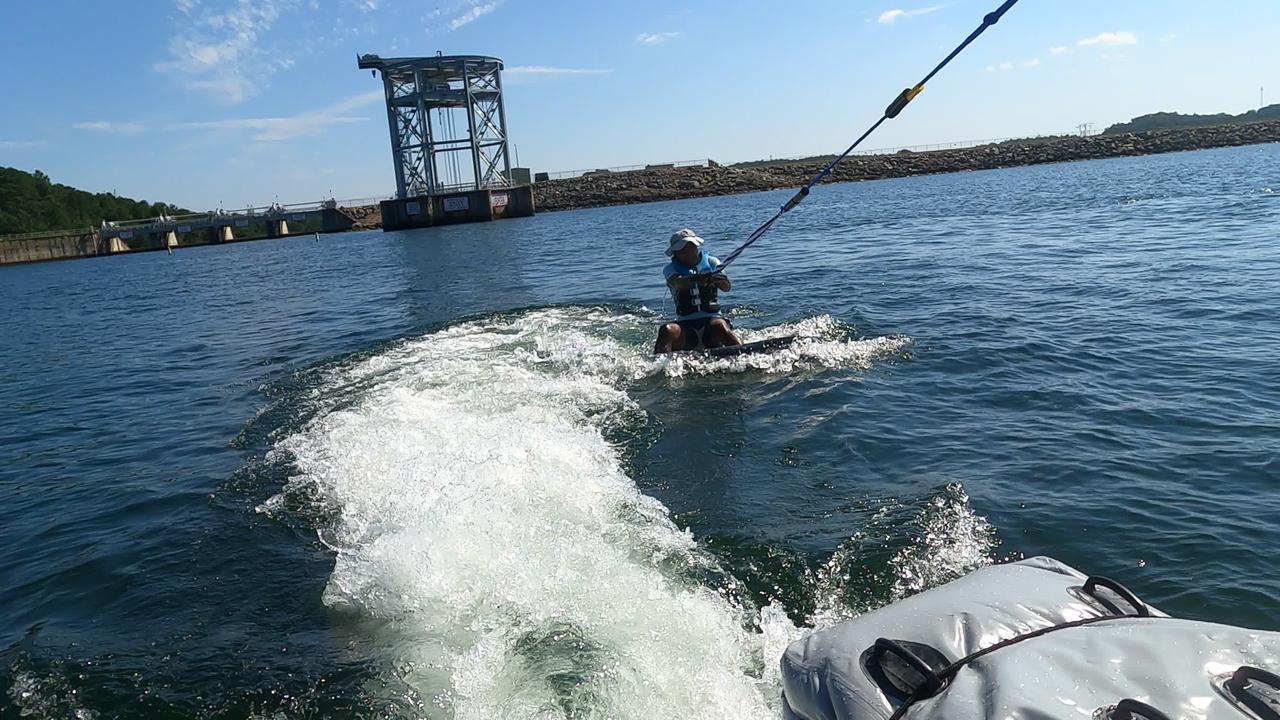

Alright. First step was getting weather to boat 😁. Here’s a before and after with wakeshaper only. Ballast is in the mail this week. First pick is nothing installed at 10.8 mph and second pick is at 10.8 mph, me hanging off the side, and the wakeshaper. Wave didnt really get much bigger (it’s the only thing my weight didnt really affect) but the wash did get moved out of the pocket (which I’m happy about). I’ll post up more for sure once the ballast arrives and it is nice enough to get back on the lake. Try to give a review on how the boat handles with literally almost triple the weight of me and my wife and what rpm’s are required. Also, of course, whether we get enough push to have a good time. 😁IMG_6740.jpegIMG_6742.jpeg

The ballast bag will be a game changer, looking forward to seeing/hearing your results.
I know very little about wake surfing, looks to me that the wave shape changed quite a bit…
What if you go a bit faster or slower?
You and me both......but length and height of the wave mostly. Slower is a shorter, maybe, taller wave and faster is longer but shorter wave. 10.8 seemed to be the biggest wave when testing it all out but I wont really know until we get the ballast and actually try surfing to see where we get the most push. This isn't a real serious thing for us it's just trying to add another dimension to our play as most of our excursions are all day affairs. With my luck we end up liking it too much for keeping the Yamaha LOL. I swear we need three boats for all I want to do.
