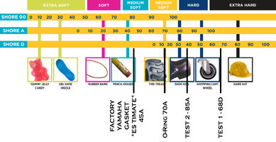

I printed that first prototype, and it fit fairly well, but the material is too hard and brittle. I ordered a softer Bambu Labs 85A TPU filament yesterday. See below Shore Hardness Scales. Unfortunately, all printed material are going to be harder and less flexible than the factory gasket, but it if fits better and tighter...it will work.
